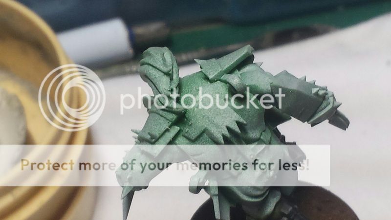

Here's a plastic mini of mine with the Tamiya grey superfine primer.  The green plastic is still visible and that's OK.  This is the best primer I've used and I've tried most.

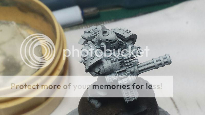

Here's the underside of a Nurgle Marine.  It's been primed with the super fine grey, sprayed black from the bottom up then with white from the top.

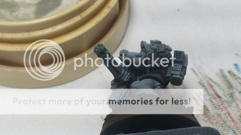

Here's the top view of the same mini

The spray looks a little thick Very Happy

Ha, not going to lie I immediately see how big of a difference in contrast just priming like that can make. Like even if you basecoat in the same colour everywhere the black will naturally shadow on the underneath. Very cool, definitely got a couple of figs that this will help with. Like the frost stonehorn and some spectral stuff. Help naturally blend the brighter colours maybe? Bright colours are difficult for me. I don't think it's something id want army wide. I enjoy a nice thick coating of black primer to use as a crutch, 100% coverage
